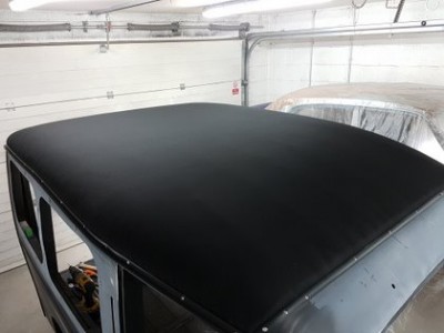

Thank you Chris for your reply.
However, it's not the gutter I have an issue with. I actually managed to salvage some suitable guttering from a scrap caravan some years ago and have now fitted it. IMHO it looks OK. See photo.
No, the issue is the width of the 1/2 round strip that goes where the tin stops and the fabric starts on the roof. For a van this is above the windscreen and for a truck (my case) all around the rubber/fabric bit in the middle. Now I do have some 1/2 round alu, which is 19mm wide. But this a) LOOKS too narrow, and b) doesn't look like it's up to the job. Hence my question.
BTW I have no problem sourcing 1/2 round alu in various widths locally
Re: Half-round aluminium strips for roof
I think I used 19mm on the last Bradford roof that I did - you could probably up this to 22mm but I think 25mm would look too wide
