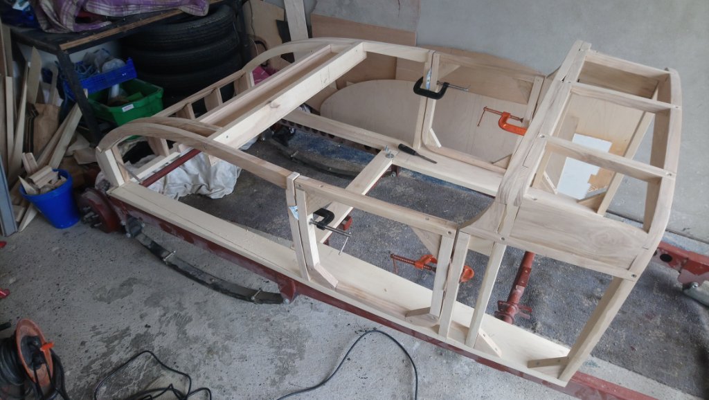

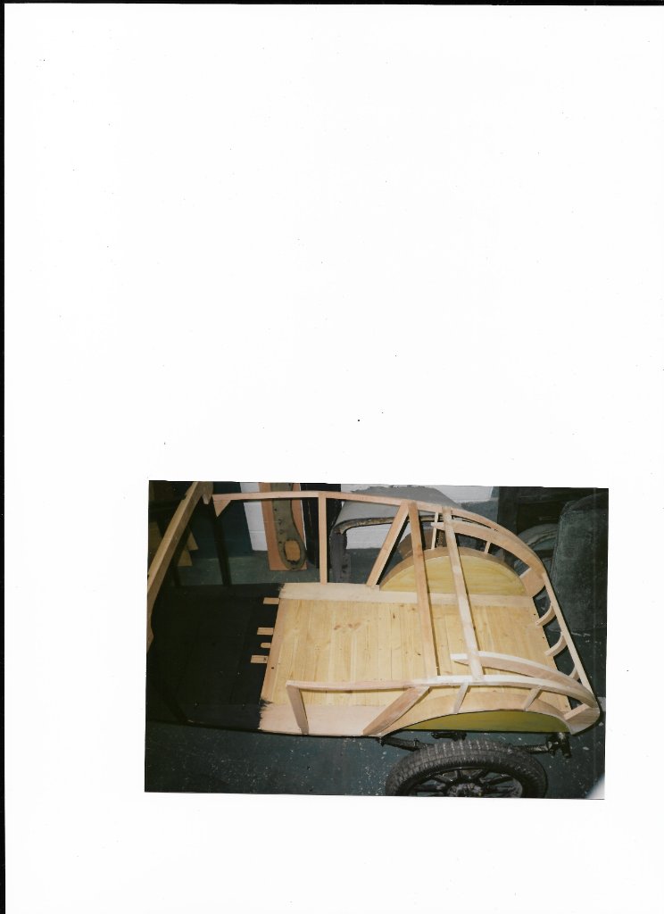

It body pictures were to help me create a Short 2 style body for my Bradford restoration as there was no bodywork with the kit of parts. The picture of the finished ash frame was in the Jowetteer a month or so back.
I got a few photos from Michael K-O and from Vic Morrison, and Vic was kind enough to measure a few bits of his Short 2 so I could scale off the photos. The dimensions were for the passenger door and the dicky seat lid. My dick seat is the same size as a genuine Short 2 but the drivers and passenger doors are slightly different.
Below are the photos
And my finished frame
I have just about completed panelling the frame now as the body tub nears completion.
