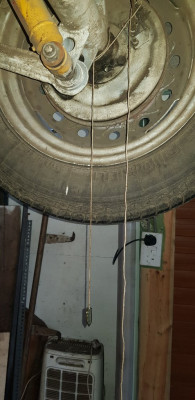

I checked out the slack in the transmission and it is 30 mm measured on the wheel rim when holding the opposite wheel and in gear.
Note the mark on the tyre is not the one being measured but the two on the wheel rim.
Is this excessive?Play in differential
Re: Play in differential

It all started with that noisy axle that needed attention. The replacement came via David Morris ‘thank you David’ This was fitted with a new crown wheel and pinion. On checking, the pre-load was over torqued, back lash excessive but the tooth pattern was close to spot on. On stripping down an excessive gap was found over the diff trust washers of 40 thou. Parts 54260 and 54262.
Four new trust washers made of equal thickness to try and maintain the running fit of the diff. Diff gears lapped in to remove the high spots. Axle reassembled and fitted and has covered over 1000 miles, oil just changed using Castrol EP 90 which is still available. As the backlash has been reduced this is perhaps an opportunity to check the amount in comparison with Keith’s exercise. I took the measurement at the chalk mark on Keith’s photo the widest part of the tyre and at this point I measured 18 mm backlash approaching about half the measurement Keith recorded.

When I get the SA on the lift I will compare with the SC, but as I suspected the SC play is excessive.
Since the SC has large tyres fitted I measured on the wheel rim, which makes your figure even smaller and as you say half mine.
