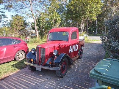

I have just bought this Bradford from the late Bill Ebzerys widow Sue.
& could not say no as it was running & registered only 1 year ago. My plans are to just get it road worthy. As a weekend play toy till my Jupiter is finished.
There are many small items that need atention but nothing major. This ute is identical to my first Bradford , I should know by now not to let emotions control me but , you only live once

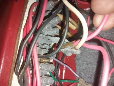

Other problem was melted wiring blocks, I will be replacing the added wiring for safety & add in a relay to the lighting.
