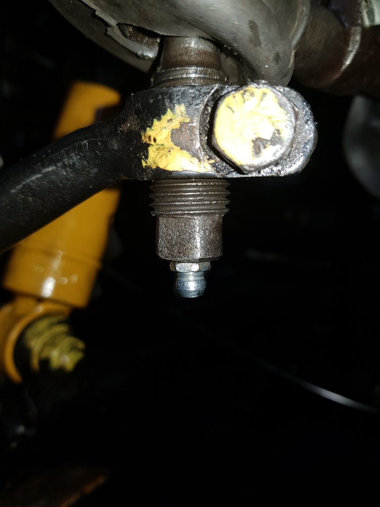

Drummond made a thick lock washer which we put some high strength threadlock onto as well as pin punching.

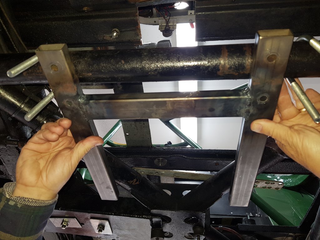

The chassis tube will be modified to allow easy removal of gearbox for clutch change.

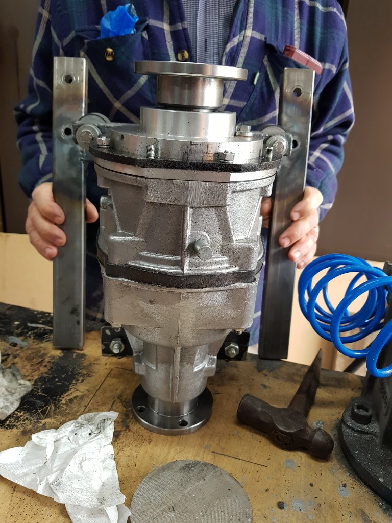

The overdrive mounting was discussed at length. Addition torque reaction buffers will be added.

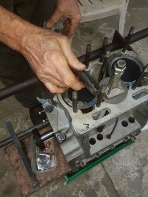

There was then a 2 week rebuild of this engine which had numerous issues mainly caused by the new block castings which had been machined with the crankshaft centre line a 1cm lower than it should be!
Once these issues had been solved we started on the race engine. This has forged pistons from Italy, bearings from NZ, push rods and block from USA, valve gear off a racing mini, Piper high lift cam as per Julian's last motor. Valves were inlets from a Ford Pinto, forged by Race Component Engineering. The exhaust valves were cut to diameter on the lathe, the inlets were straight fit. I will fill in more commentary later as we have to get it started today to take to Le Mans tomorrow.

Was the crank bearing bore really 1 centimeter low? That is huge. How did you overcome that? The timing chain would not fit for a start. Did you mean 1 mm low?.
I like the relieved skirt pistons with graphite coated thrust faces; that alone should be worth a couple of horsepower. It would be interesting to find out how their weight compares to the original Hepolite piston?

Peter Leopold made the agonising decision to remove the overdrive, mainly because it was leaking fluid perhaps causing a malfunction which started to òccur, but also because it did not improve top speed. 3 months of his life was thus wasted!

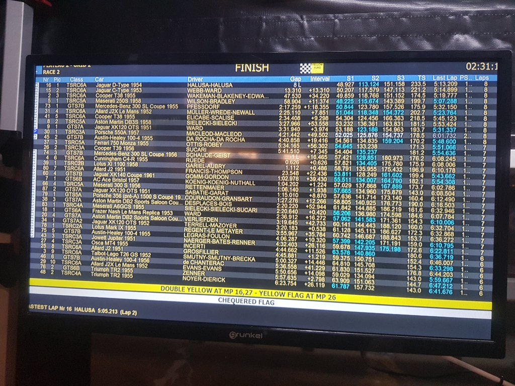

After first race lying 45 out of 75. All drivers reporting car going well and stickiñg to road.
