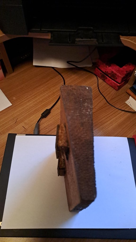

A sidenote is that on a Javelin/Jupiter, I found it difficult to get a conventional spring compressor to fit inside the combustion chamber. I made up a jig with a chamfered wooden block with two pads that fitted inside the combustion chambers, that then made the base of the block parallel with the top of the Javelin head, whilst holding the valves stationary inside the combustion chambers. I then made up a tube with a cut-out that just fitted over the top of the spring retainers, and a shaft coming out of the top. Then I put the wooden block under the head and mounted both the wooden block and the head onto the base plate of my pillar drill. The tube with the cutout fitted into the chuck, and by pressing down on the chuck lever, the tube with the cutout pressed the top of the spring retainer down, so that the collets cold be easily lifted out from the tube, through the cutout and with the help of some snipe-nosed pliers.
Of course, I remembered to thump the tops of the valves before I started, as I was taught at Beals!
I have hopefully attached a few photos of the jig.
